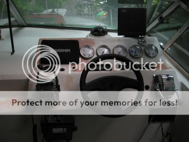

I decided to mold everything to the dash rather than adding something on top of it. Last minute decision as I kept breaking the larger lexan sheets when trying to mold them.
I still have some work to do but it gives you the feel of what the dash will look like.

oh man!!! thats "killer". ....do they still say that?
very. very nice.
so....told you boatered was a great site--my member number is 1320 or something like that. been over there for more then 10 years!
i learned so much from that site. i can't even begin to say how many hours i've spent there!
anyway--dash looks awesome...MODERN! very cool mod! totally impressed.

Thanks man. I am pretty happy with it. Still need to do some little filler and another coat of primer to get a very smooth and near perfect finish. I still have your 2 gauges BTW if you know anyone who is interested.
