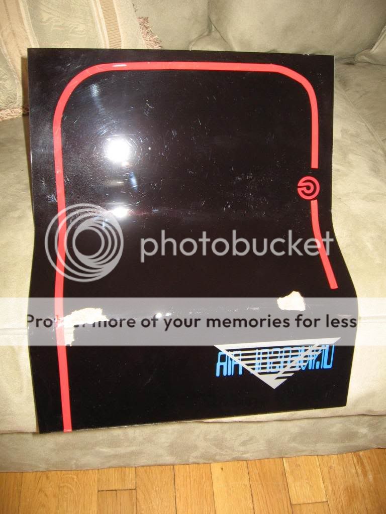

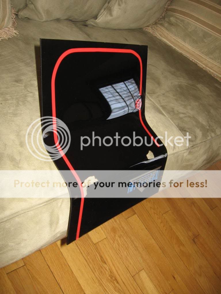

Here is a mach-up of the way I will build the new dash. I am going to copy the original with some custom touches. I used night shades spray window tint with an automotive pinstripe and decal on the underside of the panel. Of course they were just test pieces and the real deal will be done with much greater care and a Thompson decal and burgundy and gold pinstripes to match the colors of the boat.
The area that's missing paint was due to an overheat with my heat gun in that area causing the protective film to melt onto the lexan. I could not get it off so I just sprayed over it as it's just a test piece. Once I sprayed it and allowed it to dry, it pealed off. Go figure!
This is the beginning of the new layout of my equipment. Much work to do.

very nice---that's some pretty thick lexan?
