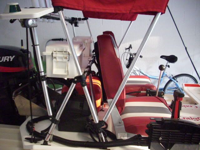

Do you have a GPS to show what speed you get with all the extra weight? That center console sure looks interesting. How many watts are you pushing on that speaker?

I started with a 15hp classic and built console and large box behind seat with starboard. With 2 people on board we had to lean forward to get up on plane so I put a 20HP on it and it solved the problem.
