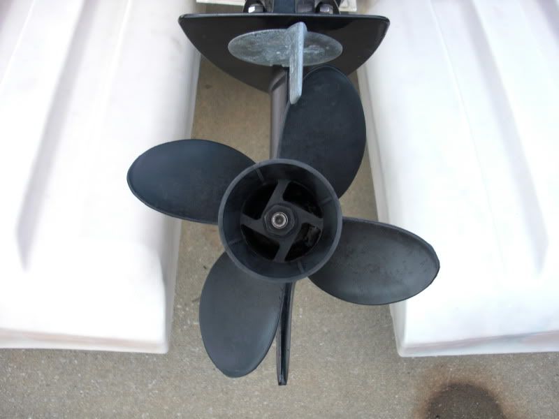

Had an interesting weekend with the 'Cat. Installed the Comprop and the stainless bolt kit, along with a CC drybox. I couldn't get my new seats installed though. My boat has the optional wing storage racks and they block the new seats from sliding all the way in. I'm going to have to rig a spacer to get the seats about 1 1/4 in. higher.
I'm not at all impressed with the CraigCat dry box. It's super-soft plastic...I can peel it up with my fingernail. There's got to be a better product out there for this purpose, and at $30 it's no bargain.
I gave the Comprop a real workout and I'm not sure how I feel about it. It's definitely a help to getting on plane. With just me aboard, I'm on plane in 8-10 seconds, versus the 30 or more with the stock aluminum prop. I really need a Tiny-Tach though because it sounds like the 25 is revving much higher now at full throttle and top speed feels way down.

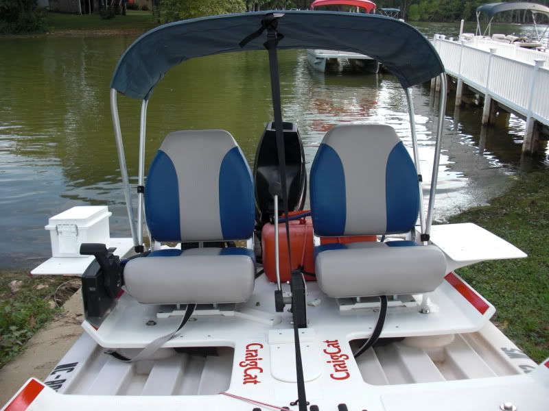

Had a GREAT Sunday on my Cat in the Gulf and at Stump
Pass, Englewood, Fl...saw a dolphin (we see them everyday
here) leap about 10' above the water -- TWICE!! very cool to
observe in the wild!...I installed new High Back seats in the
CC...very easy install...looked around, bought them at KMART
of all places!...Red w/ gray trim ...look nice, feel
great...$54.00 pretty good buy...I think they offer blue and
gray or blue and white also...made by WISE Marine...nice
seats...the backs are as high as the watertight compartment
tops...look them up om line...they should be there...

How did you install those new K-Mart seats?  Did you remove the sliding bracket that came with the CC seat and install it on the new ones?

SWSportsman Your observations on the Comprop are accurate.  A 4 blade prop dramatically improves planing time as well as mid range power just like I had described.  The cost.....top speed!  You can't have it both ways (fast planing times AND fast top speed) because you are dealing with different gearing ratios in a way.
If you liked the much faster planing times but also want to keep the top speed similar to a 3 blade, then your only choice is to go with the Powertech S.S 3 blade prop.
Stock aluminum prop = very slow planing time but can achive fastest  top speed of near 30 mph after a minute or two
Comprop composite prop = much faster planing times and improved mid range power but slower top end speeds. 2-3 mph slower and YES, you WILL notice that.
Powertech Stainless steel prop = similar planing time as the Comprop (maybe just a sec or two slower) but still pretty good AND similar top end speed to the original aluminum 3 blade (maybe just 1 mph less due to using a 12'' instead of a 13'' prop).
That's it.  These are all of your options.  Crappy, mid range, and high end.  Your choice.  Remember, the best prop you can choose will be the one that keeps your rpms between 5,500 and 6000 rpms W.O.T.  This is SO important.  A $30 Tinytach or similar will tell you this.

Bepar- yes, it's a very simple install---remove existing
seats by pulling out pin under seats...slide pvc base out (2
pieces on my model)...remove 4 screws (1/4")...line up
new seats and install will 1/4" x 2 1/2" SS screws...done!
Home Depot has 1/4' x 2 1/2" Stainless (or zinc) screws...
Hunky- here's some pics...seats are NOT heavy, waay
more comfortable and look waay better than the hard
plastic ones...notice the high-backs...higher than the stereo
deck and compartments by about 3 inches!

Heres pics of new seats...
fbid=229139310460380&set=a.229138813793763.60172.1000
00929395623&type=1&theater">

Bepar & SH...pics of new seats...
21/">
not sure I'm getting this photo thing correct!

Got my new seats installed today! Not as attractive as oceanview's, but a great improvement over the basic seats.
As you can see in the photo, I had to install 1.5in risers under the seats to get them to clear the support arms for the side platforms. This created an unforeseen problem: Now my head hits the bimini! I'll have to figure a way to raise the top also if I'm going to use it.
I'm thinking I may stick with the ComProp:
I like the increased accelleration and am getting used to the lower top speed. I reached 24mph on the GPS today and that's probably enough top end to satisfy me. I still want to get a tach reading on WOT with this prop though.

Sportsman- Congrats on your new seats! I think they look
great!...I also thought I had that unforseen problem of my
head just touching the bimini, (I didn't need to add a a riser,
as my boat does not have the outrigger platforms), but after
using the CC for awhile the seats "relaxed" a bit and there is
plenty of clearance between my noggin and the bimini...If I
were you, I would try it out on the water before I did further
changes to the bimini supports...
Enjoy your soft seats!...they change the whole ride...easier on
butt and back...especially when cutting wakes!! Enjoy!

SWSportsman  Great pics.  Those seats look so comfy compared to the stock arse-cracker fishing seats.  Good choice.
BTW, I'm glad you liked the Comprop and are experiencing the same results I have.  The only thing is that you should be getting just a little more mph out of it top end. Around 26-27mph.
You may want to run a little Seafoam in your fuel for a tank or two to clean out any built up carbon in your engine.  I did and noticed some improvement.  Also, we all run under different conditions such as load (weight) and elevation differences and nothing will improve your ride better than a prop (size) that keeps you between 5500-6000rpms.
If your engine has a good amount of hours logged on it you may need to decarbon the engine.  To do this, unscrew your spark plug and squirt a few sprays of Seafoam into the opening.  Also, spray a fair amount of it into the carb intake (air intake) of your engine and then run it.  You will smoke up the entire neighborhood in the process but what you are really doing is burning off the built up carbon.  After you do this, your engine will run much crisper and you may get some more rpms out of it which will equate to higher mph.
Do a search on "Seafoam" as it is highly reccommended by just about everyone who has used it.

Love seeing those pics!
Regarding the Bimini top, I used it for the first time yesterday, and it is very poorly placed.  One of the extensions is located in such a way that it makes it very uncomfortable to use the throttle control.  I had to actually put my hand in between the the extension bars and still found my hand pressing against the bar.  Oh well, I guess its the price to pay for cramped quarters.

The bimini top is VERY crampy when up.  Working the throttle requires you to be part Gumby if you know what I mean but it beats not having it.
