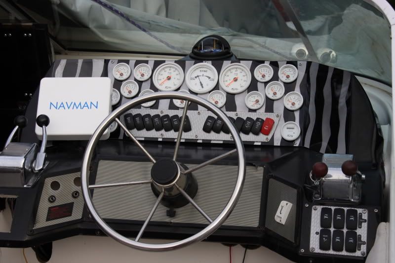

Posted: April 20 2009 at 20:27 | IP Logged Quote NoGin
Chuck can you shoot a pic of the backside of your rocker switch panel? This wiring is killing me!

Posts: 246
Posted: April 20 2009 at 21:29 | IP Logged Quote waterlogged
i can and will....but it's gonna be 3-4 weeks before i'm back.
what are you specifically needing? maybe i can get you in the right direction....

Posted: April 20 2009 at 22:04 | IP Logged Quote waterlogged
my switch panel came with the fuse panel wired in. simply a bundle of wires from the fuses to the switches(i know...not much help)

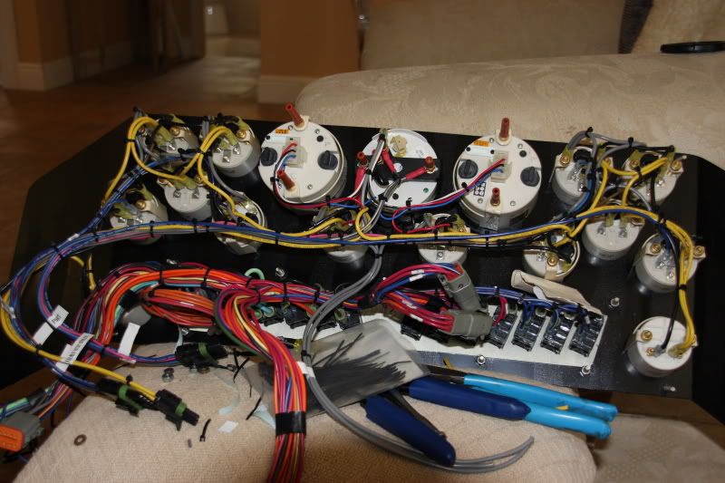

Posted: June 16 2009 at 08:20 | IP Logged Quote waterlogged
here's where we're at on the dash project. time to start wiring it.

Posted: June 16 2009 at 08:37 | IP Logged Quote NoGin
Looks great Chuck!

Posts: 246
Posted: September 29 2009 at 20:55 | IP Logged Quote waterlogged
a shot of the wiring almost complete and ready for install-notice the weatherpack connectors

Posted: October 20 2009 at 07:38 | IP Logged Quote Moosin' Around
Dash is lookin' sweet! Really like how the rocker switches are up on the vertical panel. Mine are on the horizontal above the wheel. Nice work!!
